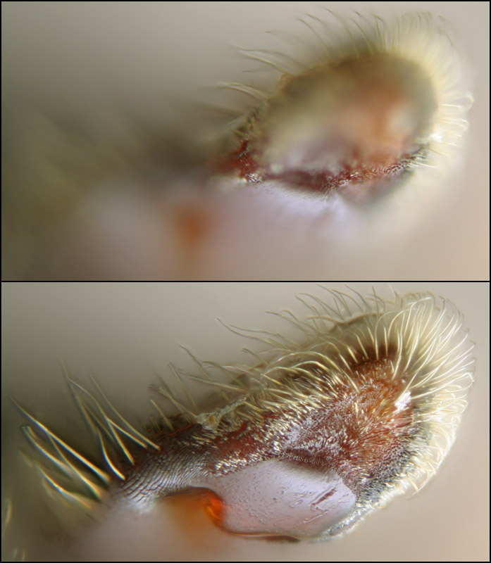

It's a bit of an afterthought, but perhaps people interested in stacking may want to see this comparison of a single frame versus the extended-depth-of-field composite. This is a fairly deep stack at wide aperture (66 frames, NA 0.4), so the effect is striking.
Reworks and reposts of my images in this forum are always welcome, as are constructive critiques.
